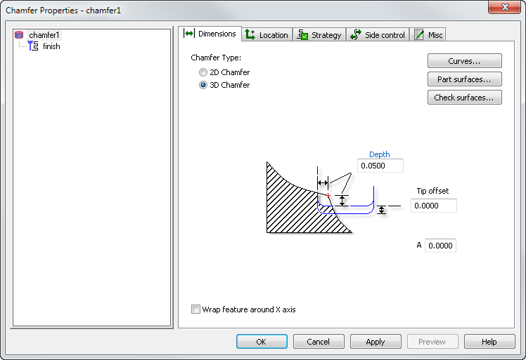

You can use the Dimensions tab of the Chamfer Properties dialog to change the dimensions of a chamfer feature.
Use a 3D chamfer feature to create chamfers from curves that are not in the XY plane, or from non-planar curves.
Enter the Depth of the 3D chamfer, which is a horizontal and vertical (negative) tool offset from the contact point on the input curve (the default is 0.020" or 0.5 mm).
Optionally enter a Tip offset, which is an additional negative vertical tool offset. The default is 0.0.
Note: The horizontal offset is compensated so that the horizontal offset remains a constant (the Depth dimension).
