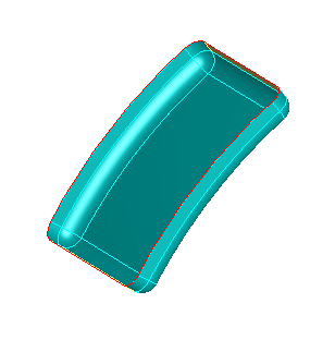

  5. Use surface edges to extract a curve from the solid model:

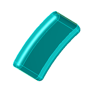

  7. Make the feature opting to wrap around the index axis.

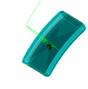

  9. Generate the toolpaths. If you have any problems consider the restrictions of 4th-axis wrapping.
