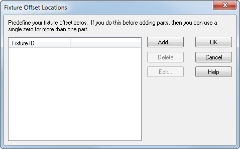

You can use the Fixture Offset Locations dialog to create, edit, and delete fixtures in a multiple fixture document.
To display the Fixture Offset Locations dialog:
- Click Fixtures in the Multiple Fixtures dialog.
- Click Fixture ID
in the Steps panel.
Fixture ID — A list of fixtures in the multiple fixture document.
Add — Displays the Fixture wizard for creating a new fixture.
Delete — Deletes the selected fixture.
Edit — Displays the Fixture wizard for editing the selected fixture.
OK — Closes the dialog and accepts the changes.
Cancel —Closes the dialog and cancels any changes.
