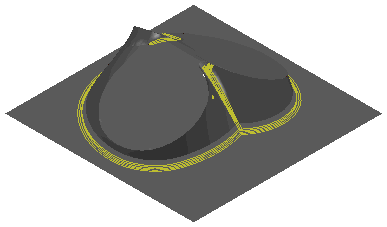

  • Along — This style of remachining creates a corner toolpath which follows the trace lines.

  • Multi-pencil — This creates a corner toolpath which follows along the trace lines. This is similar to along, but it behaves differently at intersections of more than two trace lines.
    Along
    Multi-pencil
