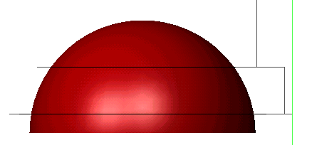

  • Stair step: The tool moves up in Z and then over in X and Y.
    This image shows a Stair step transition move on a spherical surface.

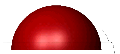

    This image shows the same surface feature using a Direct stepover.
