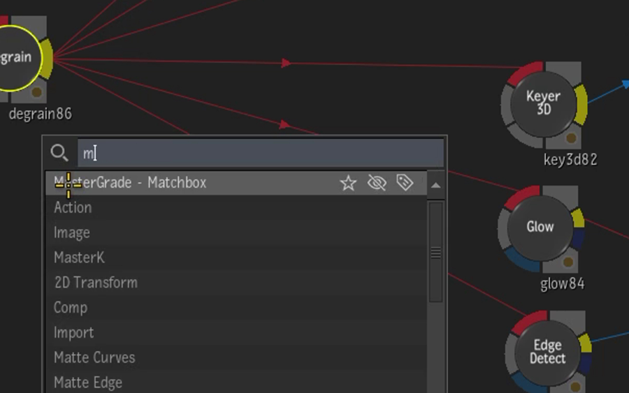

To add a node to a Selective:
Select a Selective with the HUD.
Display Search and find MasterGrade.
Press Enter.
The MasterGrade Matchbox is now available under the Selective.

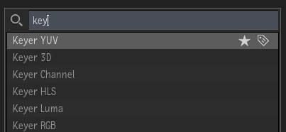

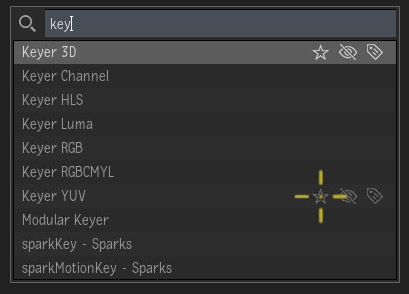

To favourite a tool:
Search for the tool.
Click the Star next to the tool you want to favourite.
Next time you display Search, Keyer YUV appears at the top of the search results.

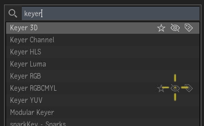

Hiding Tools
Chances are that you don't always need access to every single tool available to you. Maybe the Keyer RGBCMYL is not for you, or you only want to use the GMask Tracer and hide the legacy GMask tool.
This is why you can hide tools from Search results.
To hide a tool from the Search results:
Click the Hidden icon next to the tool.
The Keyer RGBCMYL will no longer appear in any Search results.
To make a tool appear once again in Search results:
- Open Flame Preferences
Search and remove the tool from the Hidden list.

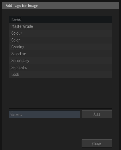

To add a tag to a tool directly from Search:
Click the Tag icon next to the tool.
Add the tag to the dialog box.
From now on, searching for Salient displays Image tool as a top result.
