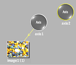

To create a branch:
Add an axis (axis2) to the scene.
From the View box, select Schematic. The Schematic view should be similar to the Before figure.
Do one of the following:
- In the Tools box, select Connect and drag the cursor from the edge of the parent node to the node that will be its child.
- Press Shift and drag a parent node over another node that will be its child. With this method, the Tools box does not have to be set to Connect mode, and can remain in S lect mode, for example.
- In the Action Setup menu, enable Auto Parent in the Schematic section, and then in the schematic, drag the cursor from the edge of the parent node to the node that will be its child. With this method, the Tools box does not have to be set to Connect mode, and can remain in Select mode, for example.
Axis2 becomes the parent of axis1, as shown in the After figure.
Before: The schematic shows axis1 as the parent of image1
After: Axis2 is made the parent of Axis1 using Connect mode
Any transformations applied to axis2 are applied to axis1 and its surface (image1). If axis1 has any transformations, they are added to the transformations from axis2. For example, if axis2 is set to 500, 100, 0 and axis1 is set to -50, 20, -30, the positions are accumulated and applied to the surface. In this case, Image1 is positioned at 450, 120, -30.
