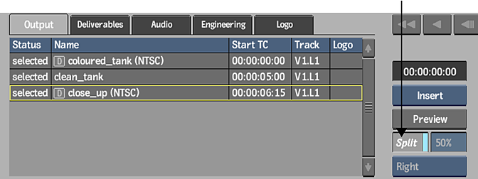

To use the split view preview option:
In the Output tab of the VTR Output module, enable Split.
The Split View controls are enabled and you can view the clip that is currently set for output alongside the content on the tape.
