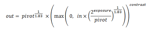

style
Declares the input data type. Required.
| Value | Meaning |
| "linear" | ![]() |
| "video" | ![]() |
| "log" | ![]() |
