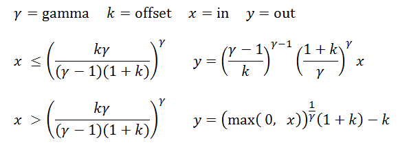

| "moncurveFwd" | Applies a function that has a linear segment near the origin (black) and a power-law segment at higher values. At the junction, the curve is continuous in both value and tangent. This type of curve is used in the Rec. 709, sRGB, and CIE L* equations. The GammaParams element must have an offset attribute.

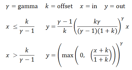

| "moncurveRev" | Applies a function that has a linear segment near the origin (black) and an inverse power-law segment at higher values. The GammaParams element must have an offset attribute.
