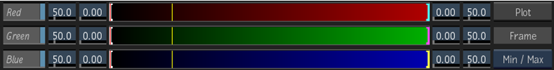

Colour Control Settings
Red Channel button
Enable to extract red channel values for the key.
Minimum Softness field
Displays the minimum red channel value of the softness range. Editable.
Minimum Tolerance field
Displays the minimum red channel value of the tolerance range. Editable.
Maximum Tolerance field
Displays the maximum red channel value of the tolerance range. Editable.
Maximum Softness field
Displays the maximum red channel value of the softness range. Editable.
Green Channel button
Enable to extract green channel values for the key.
Displays the minimum green channel value of the softness range. Editable.
Displays the minimum green channel value of the tolerance range. Editable.
Displays the maximum green channel value of the tolerance range. Editable.
Displays the maximum green channel value of the softness range. Editable.
Blue Channel button
Enable to extract blue channel values for the key.
Displays the minimum blue channel value of the softness range. Editable.
Displays the minimum blue channel value of the tolerance range. Editable.
Displays the maximum blue channel value of the tolerance range. Editable.
Displays the maximum blue channel value of the softness range. Editable.
Plot button
Activates the pick cursor. Use to sample an area of the image to display its colour value.
