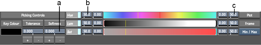

  3. Position the colour picker at the edge of the matte. To increase the softness, click and slowly drag the colour picker toward the centre of the matte. The values within the area you selected are used to adjust the maximum and minimum values for the softness range. The positions of the yellow lines change as you drag the cursor on the image.
    (a) Master Softness field  (b) Minimum Softness field  (c) Maximum Softness field  

  1. Set the minimum value for the softness range using the Minimum Softness field on the left side of the colour bar.
  2. Set the maximum value for the softness range using the Maximum Softness field on the right side of the colour bar.
Note: You can also set the softness range by entering a numeric value in the Master Softness field.
