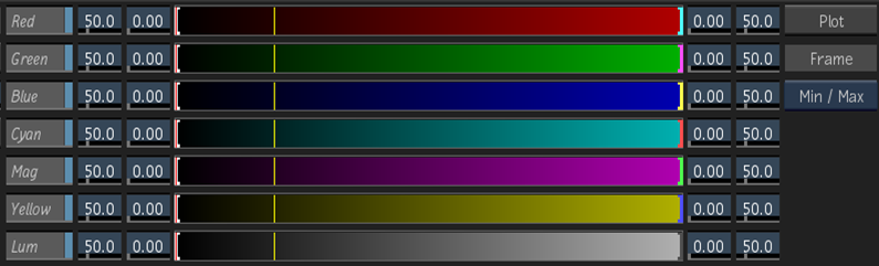

Colour Control Settings
Red Channel button
Enable to extract red channel values for the key.
Minimum Softness field
Displays the minimum red channel value of the softness range. Editable.
Minimum Tolerance field
Displays the minimum red channel value of the tolerance range. Editable.
Maximum Tolerance field
Displays the maximum red channel value of the tolerance range. Editable.
Maximum Softness field
Displays the maximum red channel value of the softness range. Editable.
Green Channel button
Enable to extract green channel values for the key.
Displays the minimum green channel value of the softness range. Editable.
Displays the minimum green channel value of the tolerance range. Editable.
Displays the maximum green channel value of the tolerance range. Editable.
Displays the maximum green channel value of the softness range. Editable.
Blue Channel button
Enable to extract blue channel values for the key.
Displays the minimum blue channel value of the softness range. Editable.
Displays the minimum blue channel value of the tolerance range. Editable.
Displays the maximum blue channel value of the tolerance range. Editable.
Displays the maximum blue channel value of the softness range. Editable.
Cyan Channel button
Enable to extract cyan channel values for the key.
Displays the minimum cyan channel value of the softness range. Editable.
Displays the minimum cyan channel value of the tolerance range. Editable.
Displays the maximum cyan channel value of the tolerance range. Editable.
Displays the maximum cyan channel value of the softness range. Editable.
Magenta Channel button
Enable to extract magenta channel values for the key.
Displays the minimum magenta channel value of the softness range. Editable.
Displays the minimum magenta channel value of the tolerance range. Editable.
Displays the maximum magenta channel value of the tolerance range. Editable.
Displays the maximum magenta channel value of the softness range. Editable.
Yellow Channel button
Enable to extract yellow channel values for the key.
Displays the minimum yellow channel value of the softness range. Editable.
Displays the minimum yellow channel value of the tolerance range. Editable.
Displays the maximum yellow channel value of the tolerance range. Editable.
Displays the maximum yellow channel value of the softness range. Editable.
Luminance button
Enable to extract luminance values for the key.
Displays the minimum luminance value of the softness range. Editable.
Displays the minimum luminance value of the tolerance range. Editable.
Displays the maximum luminance value of the tolerance range. Editable.
Displays the maximum luminance value of the softness range. Editable.
Plot button
Activates the pick cursor. Use to sample an area of the image to display its colour value.
Frame option box
Select whether to frame the histogram based on minimum and maximum slider values, the full range of histogram values, the plot and reference colours, or the [0:1] vertical and horizontal range.
