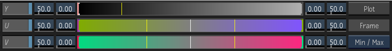

Colour Control Settings
Y Channel button
Enable to extract luminance channel values for the key.
Minimum Softness field
Displays the minimum luminance value of the softness range. Editable.
Minimum Tolerance field
Displays the minimum luminance value of the tolerance range. Editable.
Maximum Tolerance field
Displays the maximum luminance value of the tolerance range. Editable.
Maximum Softness field
Displays the maximum luminance value of the softness range. Editable.
U button
Enable to extract blue-luminance difference values for the key.
Displays the minimum blue-luminance difference value of the softness range. Editable.
Displays the minimum blue-luminance difference value of the tolerance range. Editable.
Displays the maximum blue-luminance difference value of the tolerance range. Editable.
Displays the maximum blue-luminance difference value of the softness range. Editable.
V button
Enable to extract red-luminance difference values for the key.
Displays the minimum red-luminance difference value of the softness range. Editable.
Displays the minimum red-luminance difference value of the tolerance range. Editable.
Displays the maximum red-luminance difference value of the tolerance range. Editable.
Displays the maximum red-luminance difference value of the softness range. Editable.
Plot button
Activates the pick cursor. Use to sample an area of the image to display its colour value.
Frame option box
Select whether to frame the histogram based on minimum and maximum slider values, the full range of histogram values, the plot and reference colours, or the [0:1] vertical and horizontal range.
