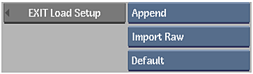

To import a raw setup file in the Modular Keyer:
  1. In the Modular Keyer, click the GMask node in the processing pipeline.
  2. In the GMask menu, click Load.
    The Load menu and file browser appear.
  3. In the Load menu, select Import Raw and Default from the Load option boxes.
  4. Enable Append or Replace.
  5. In the file browser, specify the name and path of the file to import.

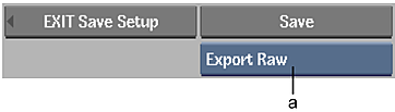

To export a raw setup file in the Modular Keyer:
  2. In the GMask Setup menu, click Save.
    The Save menu and file browser appear.
    (a) Save option box  
  3. In the Save menu, select Export Raw from the Save option box.
  4. In the file browser, specify the name and path of the file to export.
  5. Click Save.
