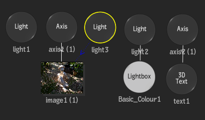

A common scenario that you may encounter when working with Lightbox is how to combine images that you don't want to shade with a geometry that you do want to shade. You can use selective lighting links and the Priority Editor to solve this issue.
Light 1 is a global light, set to Additive Light in the Light Source box.
Light 2 is the parent of the Lightbox node, and is not set to Active.

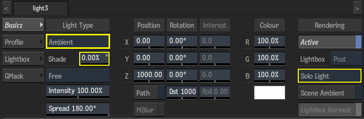

Light 3 is connected to the image node with a Light Inclusion link; the Light Type is Ambient, with the Shade set to 0%, and the Light source box set to Solo Light.

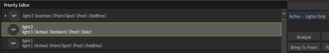

These settings, when combined with Light 3 appearing in the Priority Editor after Light 1, produces the desired effect.

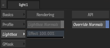

For these effects, you do not want to use the normals attenuation from the parent Light, so make sure that the Override Normals button is enabled in the Lightbox tab of the Light menu. The state of this button can be coded directly in the shader (it is enabled by default for the Clouds and Fog presets).
