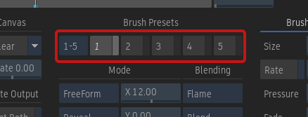

Brush Presets
There are 10 brush presets. You define a Brush Preset by first selecting a preset number and then setting the Mode, Blending, and Brush Attributes.
You recall a preset by clicking its number.

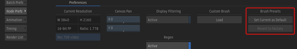

Setting Default Presets
You can save a default Brush Presets and define it as the default for all newly created Batch Paint nodes.
To create a default set:
  1. Set the default using Node Prefs Brush Preset Set Current as Default. This option creates the default from the current Brush Presets.
To restore the original Brush Presets, use Node Prefs Brush Preset Revert to Factory.
