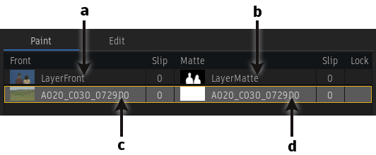

In the Paint Node menu, all sources appear in the Sources list. The first entry in the list is the front clip and matte clip.
In the schematic, source clips are connected to a Paint Node through a source node, which accepts a source front and source matte input.
A source can be a clip or the result of any process, and can include a front and/or matte clip. You can add a source node from the menu or the schematic.

(a) Front  (b) Matte  (c) Source front  (d) Source matte  
