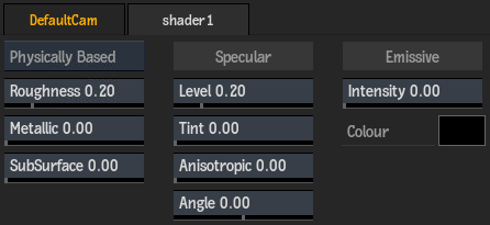

Physically Based Shader
Use the Physically Based shader (PBS) to accurately represent real-world materials. In a PBS workflow, some Physically Based shader settings override the Geom, Material, or Surface node settings. For example, specular and shine settings in the Material or Geom menu do not have any effect.
Roughness field
Displays how the light reflects from the surface, based on the roughness of the material. Use a lower value for pure specular, or a higher value for high dispersion. Editable.
Metallic field
Displays the relative weight between the dielectric and metallic BRDF model, where 0 is pure dielectric and 1 is metallic. Editable.
SubSurface field
Displays the diffuse part to approximate a subsurface scattering effect for the dielectric model (has no effect on the metallic model). Editable.
Specular Level field
Displays the Fresnel F0 specular reflectance at normal incidence for the dielectric model (for the metallic model the F0 follows the Base Color of the material). Editable.
Specular Tint field
Displays the contribution of the Base Color (Diffuse) to tint the specular for the dielectric model (has no effect on the metallic model). Editable.
Anisotropic field
Displays the distortion of the specular lobe, according to the tangent and bi-normal angles. Editable.
Anisotropic Angle field
Displays the rotation of the distortion of the anisotropic specular lobe. Editable.
Emissive Intensity field
Displays the intensity of the light emitted by the material. Editable.
Intensity Colour pot
Displays the colour of the emitted light by material. Click to change the colour.
