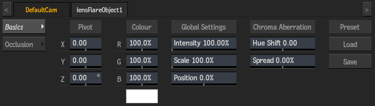

Basics Tab
Position X field
Displays the screen space position along the X axis of the Lens Flare pivot point. Editable.
Position Y field
Displays the screen space position along the Y axis of the Lens Flare pivot point. Editable.
Position Z field
Displays the screen space position along the Z axis of the Lens Flare pivot point. Editable.
Red Colour field
Displays the amount of red in attached flare components (based on the colour of the attached light). Editable.
Green Colour field
Displays the amount of green in attached flare components (based on the colour of the attached light). Editable.
Blue Colour field
Displays the amount of blue in attached flare components (based on the colour of the attached light). Editable.
Flare Colour pot
Displays the colour of the attached flare components (based on the colour of the attached light). Editable.
Global Intensity field
Displays the intensity of the attached flare components (multiplied by the intensity of the attached light). Editable.
Global Scale field
Displays the scale of the attached flare components. Editable.
Global Position field
Displays the position of attached flare components in relation to the light (0%) and pivot point (100%). Editable.
Hue Shift field
Displays the RGB offset applied to the edges of attached flare components. Editable.
Spread field
Displays the amount of refractive distortion applied to the edges of attached flare components. Editable.
Load button
Click to open a preset browser to select a lens flare preset.
Save button
Click to open the preset browser in order to save the current lens flare (including all components attached under the lens flare node).

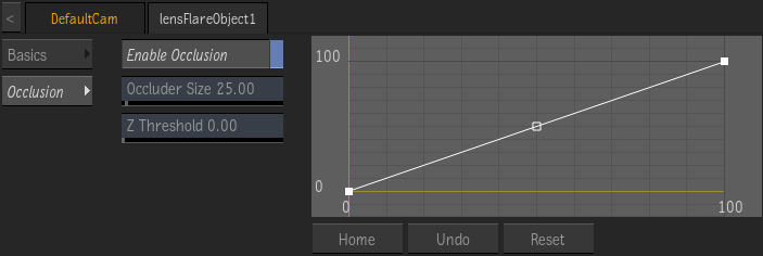

Occlusion Tab
Enable Occlusion button
Disable to have the lens flare ignore z-depth occlusion, speeding up the its rendering. BorderFX always affects the lens flare, with with Enable Occlusion disabled.
Occlusion curve
Displays the occlusion profile of the lens flare. Use to set the behaviour of the lens flare components when behind other objects in the scene.
Occluder Size field
Displays the size of fade in/out of occluded lens flare components. Editable.
Z Threshold field
Displays the transparency value at which objects start occluding the flare. Editable.
Home button
Resets the bevel curve viewer to show the whole curve.
Undo button
Undoes bevel curve operations.
Reset button
Resets the bevel curve.

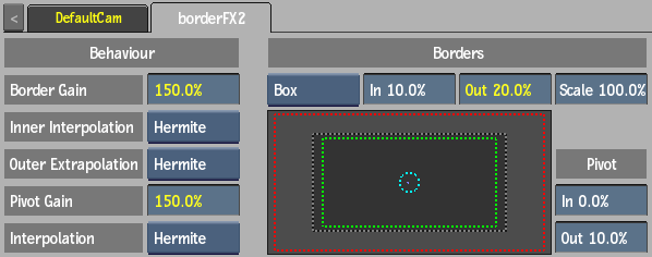

Border FX Menu Settings
Use the Border FX settings to control how the lens flare behaves when it reaches the borders of your image. A visual representation of the inner and outer borders, as well as the pivot area is displayed in the menu.
Border Gain field
Displays the amount of gain to apply to the attached lens flare components when the light reaches the defined border. Editable.
Inner Interpolation box
Select an interpolation type to define the transition between the border gain and the inner border.
Outer Extrapolation box
Select an extrapolation type to define the transition between the border gain and the outer border.
Pivot Gain field
Displays the amount of gain to apply to the attached lens flare components when the light reaches the defined pivot area. Editable.
Pivot Interpolation box
Select an interpolation type to define the transition between the pivot gain and the pivot point.
Border Mode box
Select whether Border FX settings are applied vertically, horizontally, or in both directions.
Inner Border Margin field
Displays the position of the inner border. Editable.
Outer Border Margin field
Displays the position of the outer border. Editable.
Border Scale field
Displays the scale of the border that controls where the lens flare effect occurs. Editable.
Pivot Radius In field
Displays the inner radius of the pivot point. Editable.
Pivot Radius Out field
Displays the outer radius of the pivot point. Editable.

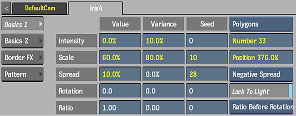

Basics 1 Tab
Intensity Value field
Displays the brightness of the component. Editable.
Intensity Variance field
Displays how much the intensity varies. Available when the Number field value is greater than 1. Editable.
Intensity Seed field
Displays the random intensity seed value. Available when the Number field value is greater than 1. Editable.
Scale Value field
Displays the size of the component. Editable.
Scale Variance field
Displays how much the scale varies. Available when the Number field value is greater than 1. Editable.
Scale Seed field
Displays the random scale seed value. Available when the Number field value is greater than 1. Editable.
Spread Value field
Displays the position of components in relation to each other. Available when the Number field value is greater than 1. Editable.
Spread Variance field
Displays how much the spread varies. Available when the Number field value is greater than 1. Editable.
Spread Seed field
Displays the random spread seed value. Available when the Number field value is greater than 1. Editable.
Spread option box
Select a behaviour for the spread settings: Centre (equal), Positive (light to pivot direction), or Negative (pivot to light direction).
Rotation Value field
Displays the level of rotation of the component. Editable.
Rotation Variance field
Displays how much the rotation varies. Available when the Number field value is greater than 1. Editable.
Rotation Seed field
Displays the random rotation seed value. Available when the Number field value is greater than 1. Editable.
Ratio Value field
Displays the aspect ratio of the component. Editable.
Ratio Variance field
Displays how much the ratio varies. Available when the Number field value is greater than 1. Editable.
Ratio Seed field
Displays the random ratio seed value. Available when the Number field value is greater than 1. Editable.
Iris Shape box
Select the shape of iris component.
For other component types, this box is grayed out and displays the type of component.
Number field
Displays the amount of components. Editable.
Position field
Displays the offset applied to the component in relation to the light (0%) and pivot point (100%). Editable.
Lock To Light button
Enable to lock the orientation of the component to the light.
Order box
Select whether ratio is applied before rotation or vice-versa.

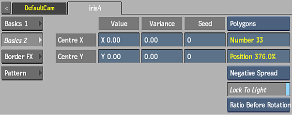

Basics 2 Tab
Centre X Position field
Displays the position of scaling and rotation of the component along the X axis. Editable.
Centre X Variance field
Displays how much the centre position varies along the X axis. Available when the Number field value is greater than 1. Editable.
Centre X Seed field
Displays the random centre X seed value. Available when the Number field value is greater than 1. Editable.
Centre Y Position field
Displays the position of scaling and rotation of the component along the Y axis. Editable.
Centre Y Variance field
Displays how much the centre position varies along the Y axis. Available when the Number field value is greater than 1. Editable.
Centre Y Seed field
Displays the random centre Y seed value. Available when the Number field value is greater than 1. Editable.

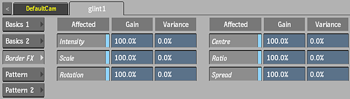

Border FX Tab
The component Border FX settings allow you to choose which how the component interacts with the parent lens flare border settings.
Border Intensity button
Enable to take into account intensity values of the parent relighting object.
Intensity Gain field
Displays the amount of gain applied to the intensity. Editable.
Displays how much the intensity varies. Editable.
Border Scale button
Enable to take into account scale values of the parent relighting object.
Scale Gain field
Displays the amount of gain applied to the scale. Editable.
Displays how much the scale varies. Editable.
Border Rotation button
Enable to take into account rotation values of the parent relighting object.
Rotation Gain field
Displays the amount of gain applied to the rotation. Editable.
Displays how much the rotation varies. Editable.
Border Centre button
Enable to take into account centre values of the parent relighting object.
Centre Gain field
Displays the amount of gain applied to the centre. Editable.
Centre Variance field
Displays how much the centre varies. Editable.
Border Ratio button
Enable to take into account ratio values of the parent relighting object.
Ratio Gain field
Displays the amount of gain applied to the ratio. Editable.
Displays how much the ratio varies. Editable.
Border Spread button
Enable to take into account spread values of the parent relighting object.
Spread Gain field
Displays the amount of gain applied to the spread. Editable.
Displays how much the spread varies. Editable.

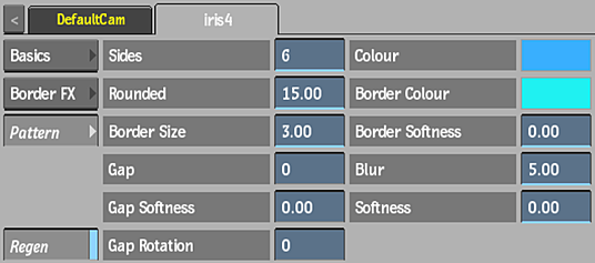

Pattern Tab(s)
Use the pattern settings to control the texture before it is applied to the lens flare or ray. The settings in the Pattern tabs vary depending on the component type. You can get a quick description of each setting by viewing its tooltip.
