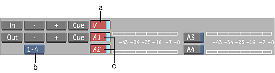

Whether you are inputting single frames, single clips, multiple clips or conforming EDLs, you must select the tracks and channels you want to capture from the VTR.
To select the tracks and channels to capture:
  1. To capture the video track, enable V.
  2. To switch between audio tracks banks, use the Toggle Audio Tracks button.
  3. To capture audio channels, enable the corresponding channel selection buttons.
    (a) Video track enabled for capture  (b) Toggle Audio Tracks button (c) Audio channels 1 and 2 enabled for capture  
    Audio meters display the gain level being captured. You cannot change this level during capture. You can modify the gain of a clip once capture is complete.
