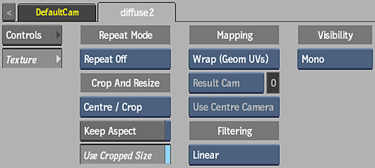

Texture Tab
Repeat Mode box
Select how the map pattern is repeated on the surface.
Fit Method box
Select a fit method option to be applied to the diffuse map.
Keep Aspect button
Enable to preserve the aspect ratio of non-square pixels (not available for the Fill fit method).
Use Cropped Size button
Enable to replace the diffuse map with the cropped size of the diffuse media. Disable to use the cropped diffuse media as is.
Mapping box
Select the type of texture mapping.

Camera box
Specify which camera's FOV to take into account when using perspective or projection mapping.
Camera field
Displays the active perspective or projection camera number. Non-editable.
Stereo Camera Projection box
Select whether to use the centre, left, or right camera from a stereo camera rig when projection mapping.
Filter box
Select the type of filtering to apply to the diffuse map.
Select:To apply:
NearestNo filtering — the pixel of the texture closest to the screen pixel is displayed.
LinearBasic bilinear filtering.
AnisotropicNon-proportional filtering between X and Y (faster to process than EWA, but with a lesser quality).
Aniso+LinearA combination of Anisotropic and Linear filtering.
EWAA high-quality elliptical weighted average filter to produce enhanced rendering results (slower to process than other filters).
EWA+LinearA combination of EWA and Linear filtering (offers the most advanced filter processing).
Tip: You can set the default filtering type in the Action Setup menu Preferences tab.
Camera Type box
Select the camera type visibility for the map. For example, you can use this setting to apply a Left Eye and Right Eye camera type for two maps that are children of the same surface or geometry in a stereo scene.
