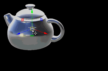

To freely move an object:
  1. In the Tools drop-down, choose Translate. Or press T.
  2. Click and hold the axis, camera, or light to move.
  3. Drag the object where you need it.
To constrain the movement of an object along one axis:
  2. Click the axis, camera, or light to move to display its manipulator.
  3. Move the cursor over one of the manipulator's axes to make it active (yellow).
  4. Click and drag the axis to move the object where you need it.
