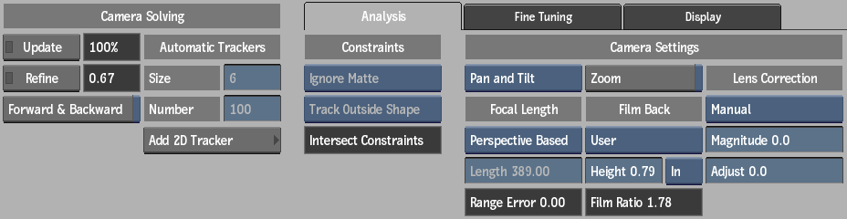

Tracking using the Analyzer Node
Step 2
Perform Camera Tracking in the Analyzer menu.
Optional steps:
  • Add mask constraints to moving areas or areas not wanted in the analysis.
  • Add properties of the camera that shot the footage to be analyzed.

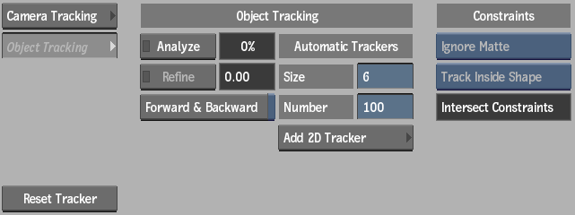

Perform Object Tracking. If needed, after camera tracking, you can track moving objects in the scene — such as inside the masks that were not tracked in the camera tracking analysis.
Object Tracking
