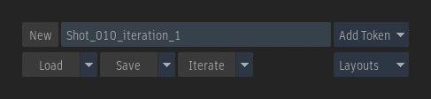

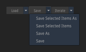

Click Save to quickly save a setup in the default destination. To access more saving options, click the drop-down beside the Save button.
Save Method Description
Save Selected Items As Save only the selected items to the destination of your choice.
Save Selected Items Save only the selected items to the current destination.
Save As Save all items to the destination of your choice.
Save Save all items to the current destination.
Note: By default, the name set above the Save and Load buttons is used as the file name. The name can be modified inside the file browser if one of the Save As option is selected.

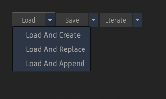

Click Load to open a file browser. Use it to load in a setup in new Batch Group. To access more loading options, click the drop-down beside the Load button.
Load Method Description
Load And Create Load the setup in a new Batch Group.
Load And Replace Replace the content of the current Iteration with the loaded setup.
Load And Append Append the setup to the current Iteration.

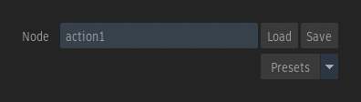

Saving Setups for Individual Nodes
Setups for the selected node in the Schematic can be saved and loaded. This setup file only contains the values and settings for that selected node. The node Load and Save buttons appear next to the node name field when a node is selected in the Schematic.
