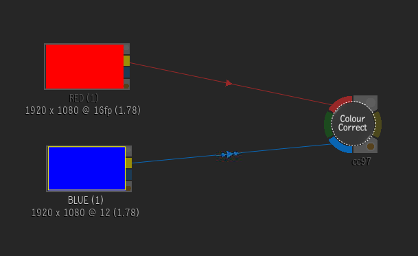

About Adaptors
Because the Batch or Batch FX environment exclusively supports 8-bit or 16-bit fp media, 10 and 12-bit media needs to be converted to 16-bit fp. While this can be done manually through the Resize or the LUT Editor, you can apply Adaptors, which automatically apply the proper bit depth conversion(s), when you bring media into Batch or Batch FX. This greatly reduces the number of mismatches in Batch or Batch FX (red dots on nodes), without the need to manually convert anything.
Note: Manually applying a LUT or Resize makes the adaptor(s) disappear.
Enable Show Adaptors in the Batch or Batch FX preferences menu. You can see that an adaptor has been applied by an arrow inside two smaller arrows on the link between nodes in the schematic. By hovering over the adaptor, the applied conversion is displayed in a text box, much in the same way as tooltips (i.e. [12-bit u -> 16-bit fp]).
