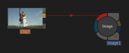

Colour coding can be applied to nodes in the Batch, Batch FX, and Modular Keyer Schematic views in the form of a colour patch behind a node's name.

A colour can be set by selecting an option in the Colour submenu from a node's context menu.
