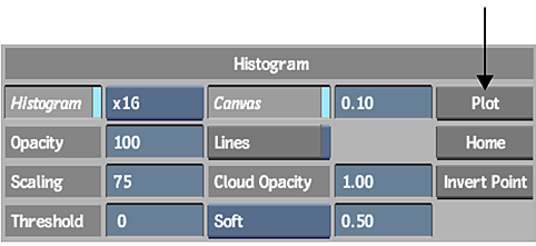

  3. Click Plot.
    Plot is enabled.
  4. Click a pixel in the key image. You can also drag the cursor in the image, then release the cursor when the colour picker is over the desired pixel.

  4. Click Plot.
    Plot mode is activated and the cursor changes to a colour picker.
  5. Select a cube in the histogram of the RGB viewer. If needed, drag the colour picker around the viewer until it is pointing to the correct colour value.
