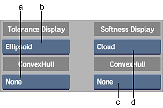

Setting the Tolerance and Softness Ellipsoids
As you sample the tolerance and softness in a key, corresponding key elements appear in the RGB viewer. Set the appearance of the tolerance and softness ellipsoids to make it easier to work with them while refining the precision of the key.
Use the Key menu to set the display of the tolerance and softness in the RGB viewer.
(a) Tolerance Convex Hull box (b) Tolerance Display box (c) Softness Convex Hull box (d) Softness Display box
Tolerance and Softness Display boxes
Select an option to set the appearance of the tolerance and softness ellipsoids.
Select: To display:
Ellipsoid An opaque ellipsoid of the exact colours sampled.
Cloud A semi-transparent grey ellipsoid. You can set the transparency of the ellipsoid using the Cloud Opacity field in the Preferences menu. See Setting the Cloud Opacity.
Wireframe The ellipsoid as a wireframe outline.
None No ellipsoid. Note that when an ellipsoid is not displayed, it still has an effect on the image.
Tolerance and Softness Convex Hull boxes
Select an option to set the appearance of the tolerance and softness convex hulls.
Select: To display:
Vertices Only the vertices of the convex hull.
Surface Only the surface of the convex hull.
Vert&Surf Both the surface and vertices of the convex hull.
None No convex hull.
Note: Vertices do not appear on keyed elements when Tolerance Display or Softness Display is set to Ellipsoid (because an ellipsoid is opaque).

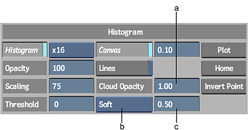

You can control the opacity of the Cloud setting of ellipsoids and patches as they appear in the RGB viewer using the Cloud Opacity fields in the Preferences menu.
(a) Overall Opacity field (b) Key Element box (c) Individual Opacity field
You can adjust the opacity for all key elements or for individual key elements:
  • To set the cloud opacity for all ellipses and patches, use the Overall Opacity field.
  • To set the cloud opacity for an individual key element, select the element from the Key Element box, then set the opacity in the Individual Opacity field.
