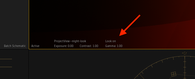

OCIO views may be represented as a sequence of discrete components and may include one or more looks from the config. You may use the Look on/off toggle button in the viewports to turn the look(s) on or off. Alternatively, you may use the "Look Transform" toggle button in the View settings panel.
By default, it is always on. If an OCIO view does not contain a discrete look component, the Look toggle button will not be present.
When baking a view into images with the View Transform mode in the Colour Management tool, the look is always applied.
