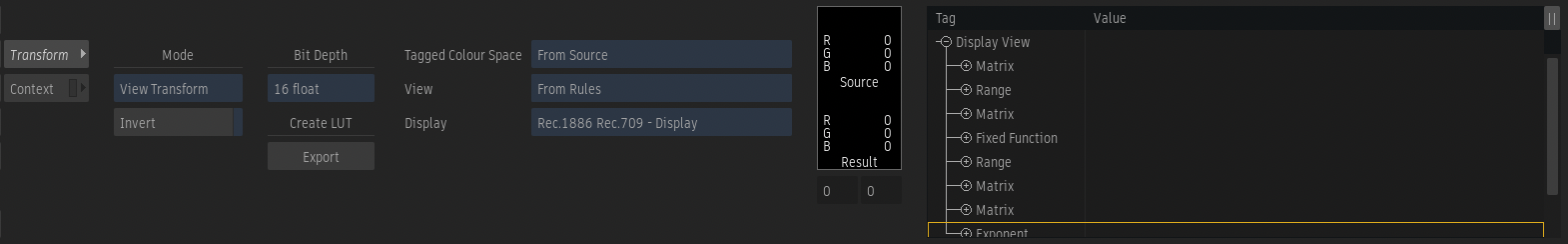

View Transform settings
Tagged Colour Space option
Select "From Source" to use the tagged colour space of the input or select another value to override it.
View Transform option
Before selecting a View, first set the Tagged Colour Space and Display since the list of Views is filtered based on those values. Select "From Rules" to use the highest priority OCIO View for the Tagged Colour Space and Display. Use the "All Views" sub-menu to access all the views in the config for the selected display, not filtered by the OCIO viewing rules.
Display option
Select the Display from the OCIO config that you want to use. The "Current Video Preview Device" option is taken from the Colour Management Preferences. If the display has a corresponding display colour space in the config, that will be used to tag the output. Otherwise, the output will be tagged with the colour space specified in the view.

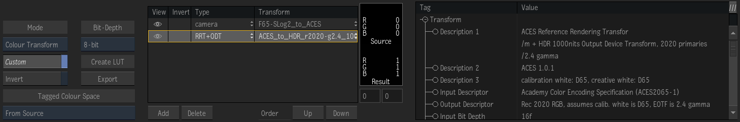

Colour Transform Settings
Import
Open the file browser to import a LUT or colour transform using OpenColorIO.
Custom
Apply a custom chain of colour transforms.
Add
Add a new row to the end of the transform chain. Click in the Type column to select or change the transform type, and then click in the Transform column to select a transform.
Delete
Remove the selected transform from the chain.
Up
Move the selected transform earlier in the chain.
Down
Move the selected transform later in the chain.

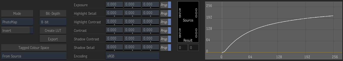

PhotoMap Settings
Invert
Enable to apply the inverse of the tone-mapping parameters function to convert video media to scene-linear media.
Red Exposure field
Displays the luminance level of the red channel for the display image.
Green Exposure field
Displays the luminance level of the green channel for the display image.
Blue Exposure field
Displays the luminance level of the blue channel for the display image.
Red Highlight Detail field
Displays the value for the detail in the light areas of the red channel.
Green Highlight Detail field
Displays the value for the detail in the light areas of the green channel.
Blue Highlight Detail field
Displays the value for the detail in the light areas of the blue channel.
Red Highlight Contrast field
Displays the value for the contrast in the light areas of the red channel.
Green Highlight Contrast field
Displays the value for the contrast in the light areas of the green channel.
Blue Highlight Contrast field
Displays the value for the contrast in the light areas of the blue channel.
Red Contrast field
Displays the value for the midtone contrast in the red channel.
Green Contrast field
Displays the value for the midtone contrast in the green channel.
Blue Contrast field
Displays the value for the midtone contrast in the blue channel.
Red Shadow Contrast field
Displays the value for the contrast in the dark areas of the red channel.
Green Shadow Contrast field
Displays the value for the contrast in the dark areas of the green channel.
Blue Shadow Contrast field
Displays the value for the contrast in the dark areas of the blue channel.
Red Shadow Detail field
Displays the value for the detail in the dark areas of the red channel.
Green Shadow Detail field
Displays the value for the detail in the dark areas of the green channel.
Blue Shadow Detail field
Displays the value for the detail in the dark areas of the blue channel.
Encoding option box
Select a standard format for the colour space.

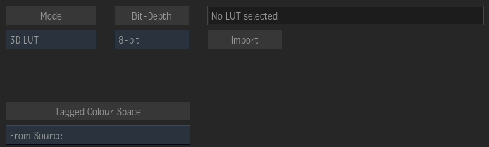

3D LUT Settings
Import
Open the file browser to select a legacy Flame LUT for import.

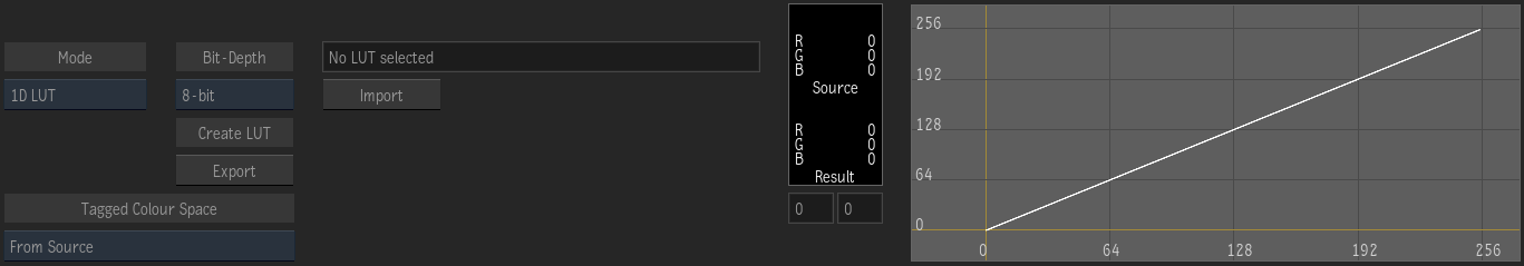

1D LUT Settings
Import

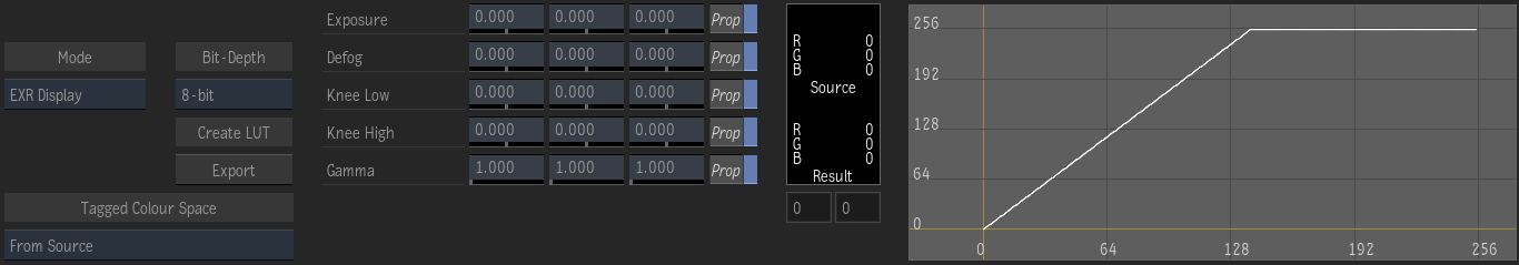

EXR Display Settings
Red Exposure field
Blue Exposure field
Red Defog field
Displays the value to be subtracted from red colour values to reduce fogging of the image.
Green Defog field
Displays the value to be subtracted from green colour values to reduce fogging of the image.
Blue Defog field
Displays the value to be subtracted from blue colour values to reduce fogging of the image.
Red Knee Low field
Displays the lower limit of the compressed pixel range for the red channel.
Green Knee Low field
Displays the lower limit of the compressed pixel range for the green channel.
Blue Knee Low field
Displays the lower limit of the compressed pixel range for the blue channel.
Red Knee High field
Displays the upper limit of the compressed pixel range for the red channel.
Green Knee High field
Displays the upper limit of the compressed pixel range for the green channel.
Blue Knee High field
Displays the upper limit of the compressed pixel range for the blue channel.

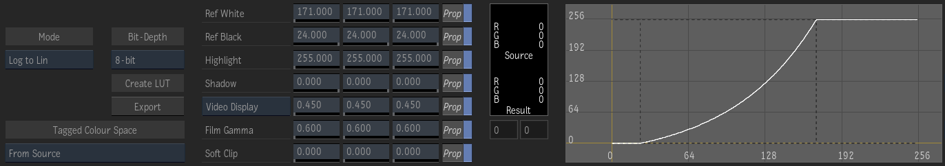

Log to Lin, Lin to Log, and Gamma Settings
Red Reference White field
Displays the lower limit at which red channel values are considered white.
Green Reference White field
Displays the lower limit at which green channel values are considered white.
Blue Reference White field
Displays the lower limit at which blue channel values are considered white.
Red Reference Black field
Displays the upper limit at which red channel values are considered black.
Green Reference Black field
Displays the upper limit at which green channel values are considered black.
Blue Reference Black field
Displays the upper limit at which blue channel values are considered black.
Red Highlight field
Displays the value at which greater red channel values are clamped.
Green Highlight field
Displays the value at which green channel values are clamped.
Blue Highlight field
Displays the value at which blue channel values are clamped.
Red Shadow field
Displays the value at which lower red channel values are clamped.
Green Shadow field
Displays the value at which lower green channel values are clamped.
Blue Shadow field
Gamma Correction box
Select preset gamma correction values (Video Display) or custom values.
This setting is available for Log to Lin and Lin to Log.
Red Gamma Correction field
Displays the gamma correction value for the red channel.
Green Gamma Correction field
Displays the gamma correction value for the green channel.
Blue Gamma Correction field
Displays the gamma correction value for the blue channel.
Note: The following settings are available for Log to Lin and Lin to Log.
Red Film Gamma field
Green Film Gamma field
Blue Film Gamma field
Red Soft Clip field
Displays the level of adjustment to the shoulder of the conversion curve for the red channel. The upper limit is dependent on the channel's current reference white value. To create softer highlight, drag right when using a linear curve. Drag left when using a logarithmic curve.
Green Soft Clip field
Displays the level of adjustment to the shoulder of the conversion curve for the green channel. The upper limit is dependent on the channel's current reference white value. To create softer highlight, drag right when using a linear curve. Drag left when using a logarithmic curve.
Blue Soft Clip field
Displays the level of adjustment to the shoulder of the conversion curve for the blue channel. The upper limit is dependent on the channel's current reference white value. To create softer highlight, drag right when using a linear curve. Drag left when using a logarithmic curve.
