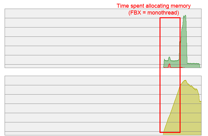

The GCG stores only the information needed by Golaem to rebuild the character at render time. It is therefore faster to load.
On top of that, reading a GCG file can be multithreaded, which is impossible with FBX files. It then results on faster render previz geometry creation (reducing the waiting time at the first simulation of a scene from minutes to seconds) and rendering initialisation.
However because it does not store as much information as the FBX file, the GCG is a stricter format and bears some limitations (mainly the character should have only one bind pose, and it should be clean). See the full list here
Comparison of CPU (green) and Memory (yellow) usage when rendering 25K CrowdMan with Arnold using FBX or GCG
