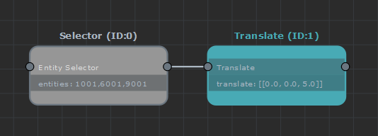

Here is an example graph:

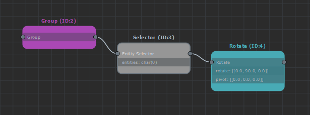

And its group subgraph :
And finally the corresponding .gscl file:
  "connections": \[
    \[ 3, 4\],
    \[2, 3\],
    \[0, 1\]
  "layoutFileVersion": 1,
  "nextNodeId": 5,
  "licenseHashKey": 0,
  "currentFilePath":
"C:/temp/selectorChar/export/selectorChar2.gscl",
  "groups": \[\],
  "nodes": \[
      "name": "Rotate",
      "type_name": "Rotate",
      "active": 1,
      "attributes": \[
          "frames": \[\],
          "values": \[
                0.0,
                90.0,
                0.0
          "type": 6,
          "flags": 16,
          "name": "rotate"
          "frames": \[\],
          "values": \[
                0.0,
                0.0,
                0.0
          "type": 6,
          "flags": 16,
          "name": "pivot"
      "type": 1,
      "ID": 4,
      "GUI_pos": \[
        1514.1723065776293,
        142.0
      "active": 1,
      "entities": "char(0)",
      "ID": 3,
      "name": "Selector",
      "GUI_pos": \[
        1294.1723065776293,
        122.0
      "name": "Group",
      "type_name": "Group",
      "active": 1,
      "attributes": \[
          "frames": \[\],
          "values": \[
              1
          "type": 2,
          "name": "rootNodeId"
          "frames": \[\],
          "values": \[
              0,
              1
          "type": 2,
          "name": "childrenNodeIds",
          "flags": 1
      "type": 22,
      "ID": 2,
      "GUI_pos": \[
        1073.0,
        83.0
      "active": 1,
      "entities": "1001,6001,9001",
      "GUI_pos": \[
        830.0,
        122.0
      "name": "Selector",
      "ID": 0
      "name": "Translate",
      "type_name": "Translate",
      "active": 1,
      "attributes": \[
          "frames": \[\],
          "type": 6,
          "values": \[
                0.0,
                0.0,
                5.0
          "flags": 16,
          "name": "translate"
      "type": 3,
      "ID": 1,
      "GUI_pos": \[
        1050.0,
        122.0
  "rootTransformId": 4
