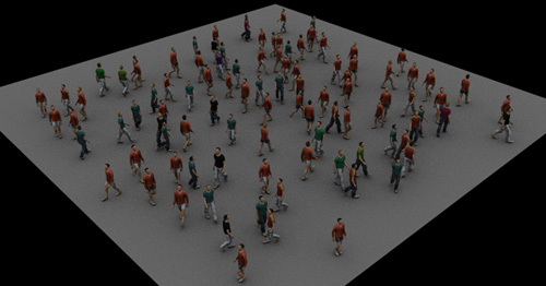

Rib Files created by Golaem Crowd (either from the Render Proxy or from the Simulation Exporter) defines how Renderman should handle the exported Simulation Caches and render them as Crowd Characters. Here's how those information are stored in the .rib file for the following example:
And the corresponding .rib file:
