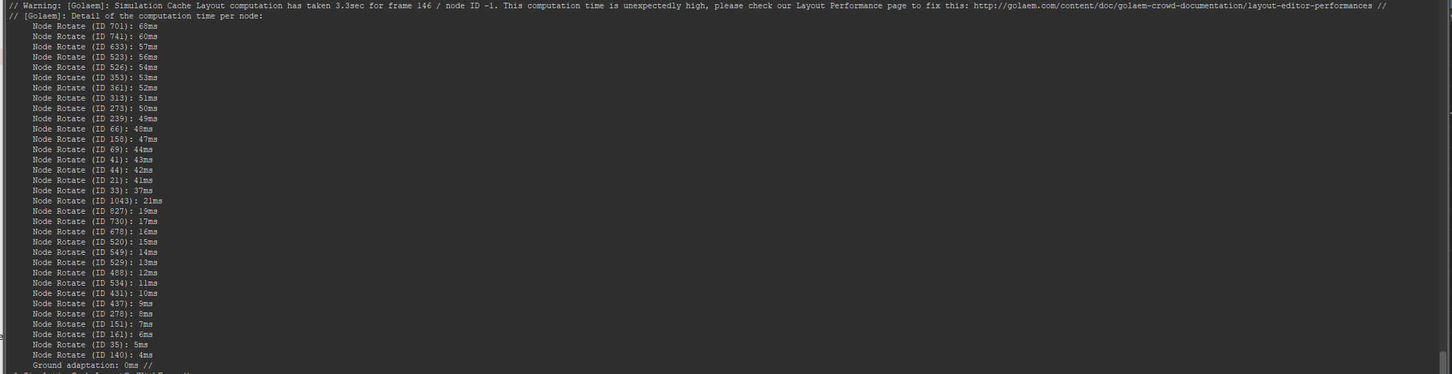

Whenever a layout computation takes longer than one second a message will appear in the Script Editor telling how long it took. If you set the Golaem Crowd Severity log Level to Info, the log will also give a detail of where the time was spent:
Info message detailling where computaiton time is spent in the Layout
