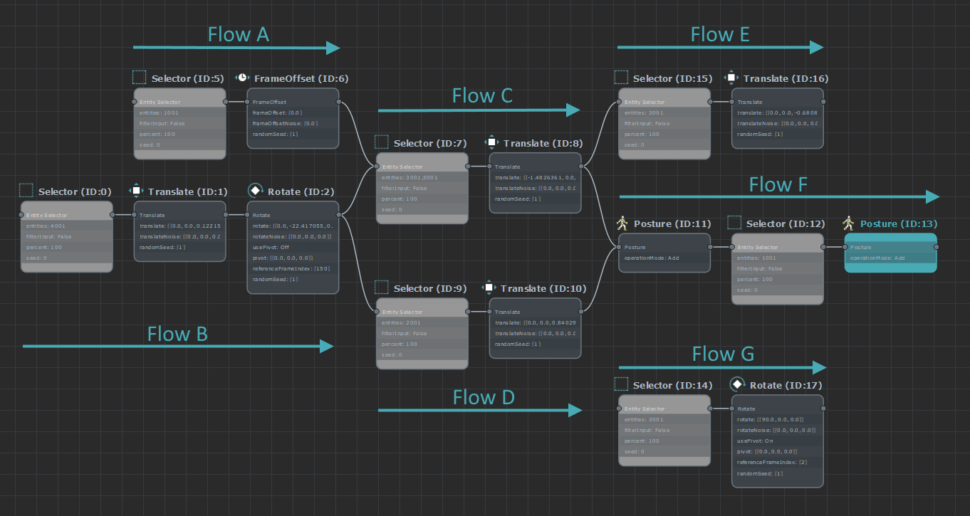

Execution flow
The layout graph executes any node that contributes (is directly or indirectly connected on the left) to the root node (colored in cyan).
A node that is connected to the left of another node will always be executed first.
When a merge occurs, all nodes connected to the left of the merge node will be executed first, but there is no guarantee about the order in which it's going to be executed. If the order of execution matters, then nodes should be connected in the same single line of execution.
For instance, a layout graph that looks like this:
Will have the following execution flow:
- Flow A will be executed before flow C, but may be executed after D as it is not connected to its left
- Flow B will be executed before both flow C and flow D
- Flow C and D will both be executed before Flow F
- The Operator that is at the beginning of Flow F will use a selection that is a union of the selections from Flow C and D
- Flow F is executed last (as it includes the root node)
- Flow E will never be executed (it's not connected to the left of the Root node)
- Flow G will never be executed (it's not connected to the left of the Root node)

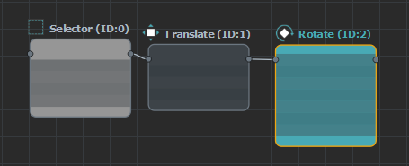

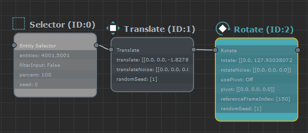

Layout Editor Display Level of details
The editor can use three different display modes, depending on the zoom level, to keep if fast and readable.
While the editor is focused on a few nodes, the level of detail is
maximum, showing each node parameter and its value.
When the editor is being zoomed out, the parameters are not displayed
anymore to (performance saving) as they are not readable anymore.
When zoomed out further, the title logo starts to be unreadable, and is
moved in a bigger version, displayed inside of the node, which helps to
keep track of what are the transformation types of each node.
