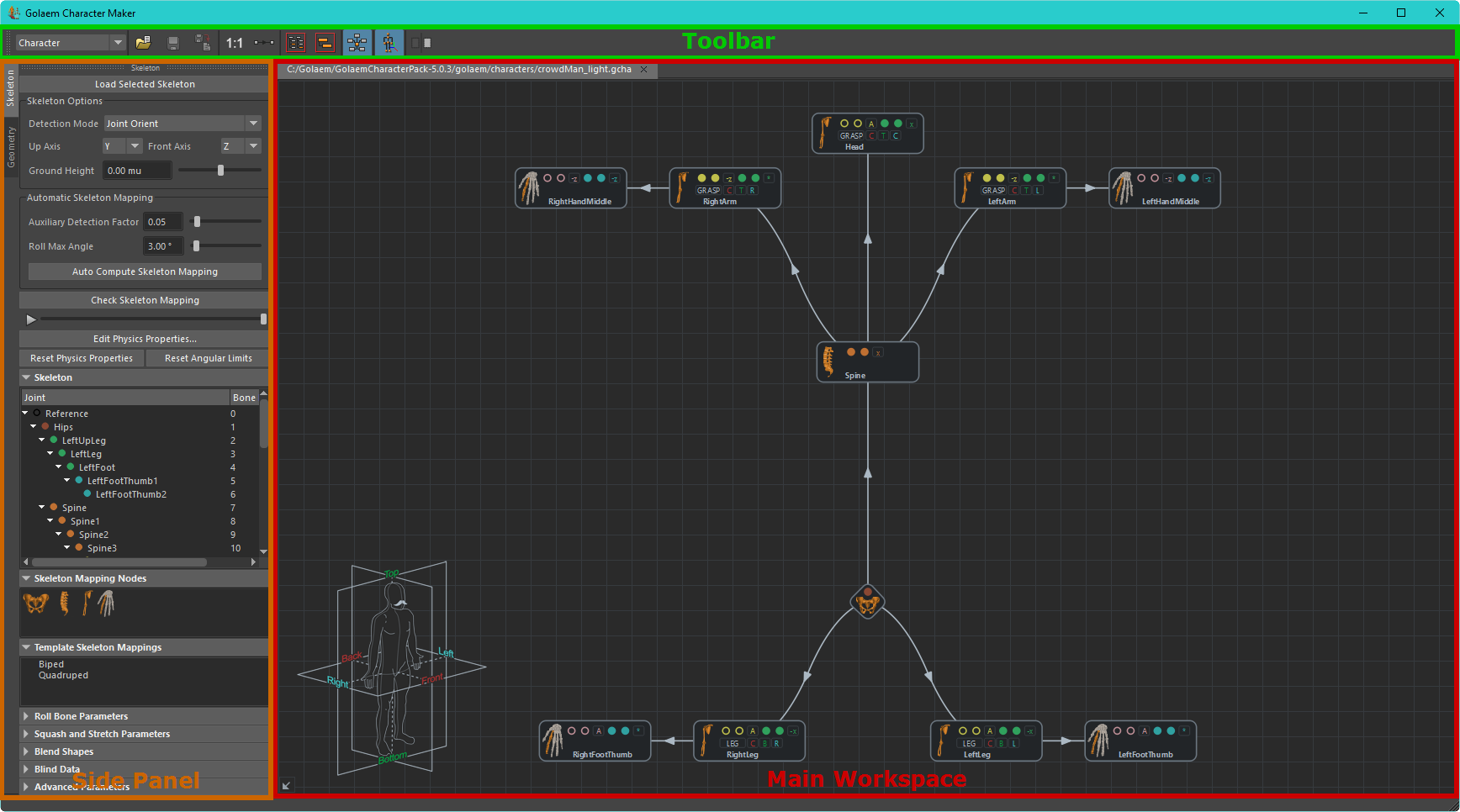

GUI
The Character Maker window is made of 3 main components:
- Character Maker Toolbar: lets you change the mode of the Character Maker through a combobox: Character, Motion or Motion Mapping. It also contains quick access buttons allowing to open or save the file currently being edited, to change the display or to edit in the Main workspace
- Side Panel: it changes according to the mode selected in the toolbar:
- Character Mode: create, edit and save a Character File (.gcha)
- Motion Mode: load, edit and save a Motion File (.gmo)
- Motion Mapping Mode: create, edit and save a Motion Mapping File (.gmm)
- Main Workspace: node-based graphical interface where the Skeleton Mapping, Geometry Assets or Motion Mapping are created or edited
The Character Maker Main Window

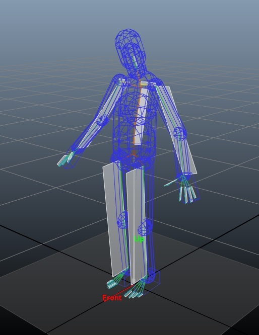

Whenever a character file is loaded, the Character Maker will also create a Character Maker Locator in Maya. The locator displays the Golaem Crowd skeleton and some of its properties, as well as its animation if any, in Maya's viewport. It also lets you check that the skeleton and animation were loaded and edited correctly.
The Character Maker Locator
