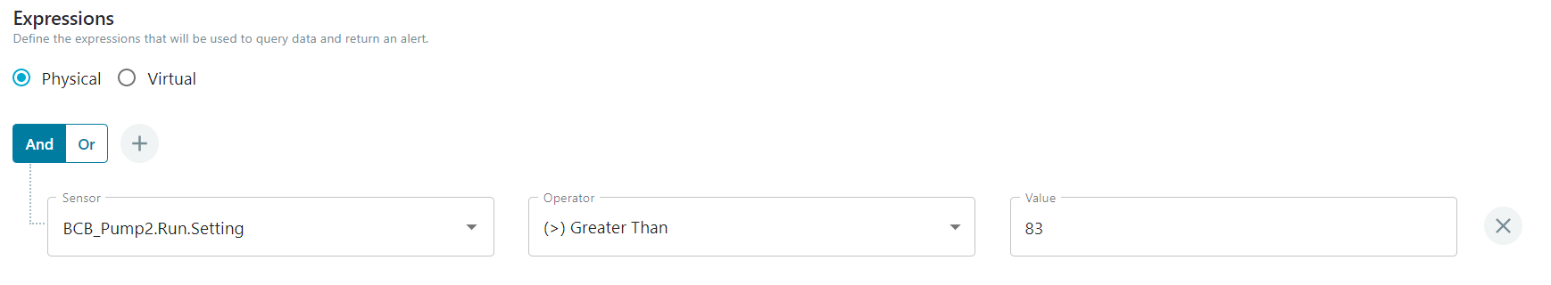

- Under Expressions, choose between Physical and Virtual.
Physical sensors retrieve live sensor data, while Virtual sensors are time series data generated within Info360 Insight (e.g., in an analytic).
- Click on the plus sign (+) to define an expression.
- Select Sensor.
- Select a sensor, operator, and enter a value.
- You can add additional expressions if you wish. If you do, choose which logical operator (And / Or) you want to apply.
