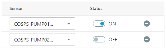

For example, if there are two pumps at a station and one flow and pressure sensor at the confluence outflow of both pumps, you can create filters to show the readings when pump 1 is on and pump 2 is off and compare these with the manufacturer curve for pump 1.
To add filters:
  1. Once you have added your pump performance chart, click on the three dots icon and select Configure.
  2. Click on Source to expand it and then click on Show More Settings.
  3. Under Pump Status Filter, click + Add Sensor and then select from the list of available Status or Setting sensors.
  4. Use the toggle to select whether you want to filter for when the pump is On or Off.
  5. Add as many sensors as you need, then click Update.
