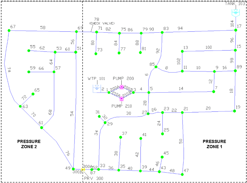

The SampleSeg project modified in this tutorial illustrates how InfoWater Pro Skeletonizer automatically performs RST applications to remove excessive pipe segments and reduce large, detailed network models to a manageable size ready for analysis. The SampleSeg model schematic is shown below. The completed model contains two pressure zones and consists of the following components:
- One reservoir (storage node 101)
- One tank (storage node 103)
- Two pumps located at the water treatment plant and numbered 200 and 210
- One pressure reducing valve located at node 300
- One check valve located in pipe 78
- Fifty-eight pipes
- Forty-five junction nodes
- Total system demand of 707 gpm

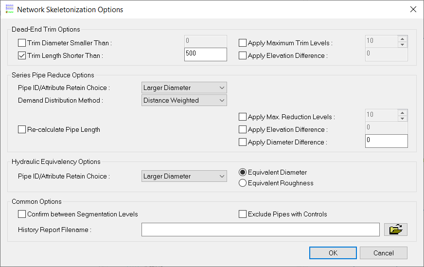

- Choose the
Options button from the InfoWater Pro Skeletonizer dialog box and enter the data shown below in the InfoWater Pro – Network Skeletonizer Options dialog box.
- Click on the OK button to close the dialog box.

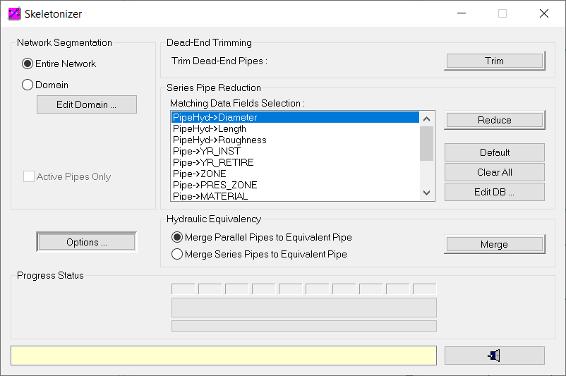

Step 3: Launch the Network Trim Module

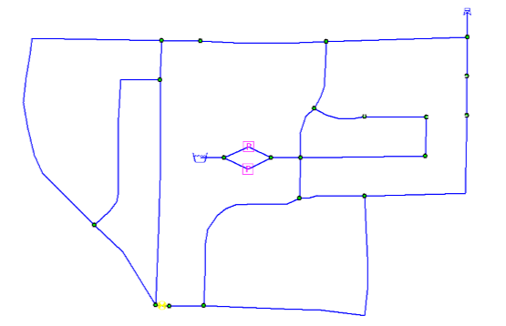

You have entered all required information to execute a network trim application. Choose the Trim button to remove all dead-end mains of length shorter than 500 ft. For this application, all dead-end mains (branching pipes) meet the minimum length criterion specified and a total of 11 pipe segments are removed from the network. These include: pipes 24, 32, 38, 42, 46, 62, 66, 72, 80, 84, and 88. The new network configuration is shown below. As shown in the figure below, the network now consists of 47 pipes and 34 junction nodes. Select the DB Editor command from the Edit menu, open the Junction Demand (Modeling) Data table, highlight the Demand1 field, and then click on the Field Statistics icon to verify that the total system demand remains 707 gpm.

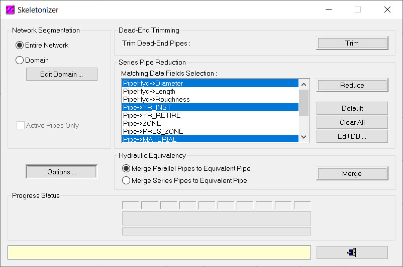

Step 4: Run the Network Reduce Application
You will now run the network reduce application to merge all pipes in series that have similar diameter, material, and installation date. To accomplish this task, select “PipeHyd- >Diameter”, “Pipe- >YR_INST”, and “Pipe- >MATERIAL” data fields from the Matching Data Field Selection list in the Skeletonizer dialog box, and choose the Reduce button to execute the network reduce application.
The new network configuration is shown. The new network has been further reduced to a total of 33 pipes and 20 junction nodes. The total system demand remains at 707 gpm.

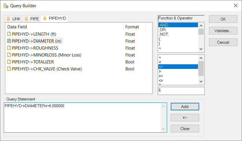

- The DB Query dialog box appears on the screen. Now build a new database query that includes all pipes with a diameter less or equal to 6 inches:
- Choose the New
button in the upper left-hand corner of the DB Query dialog box. Enter a query ID and description of “QRY1, Pipes 6 inches and below”.

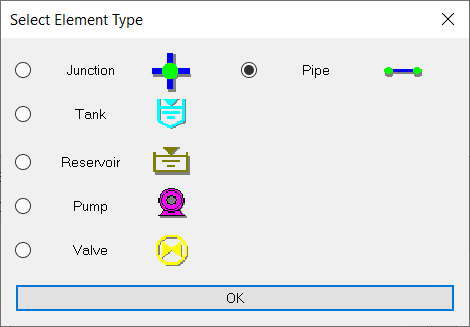

- Choose OK and the Element Type dialog box will appear.
- Choose Element Type of Pipe and click OK.
- Select the
Build Query button.
- Choose the PIPEHYD tab, select the PIPEHYD- >Diameter data field, select the “ <=” operator, type “6” in the field below the Function & Operator area. Click on the
Add button to view your query statement: PIPEHYD→DIAMETER <=6.0.
Click
OK to close the Query Builder dialog box.

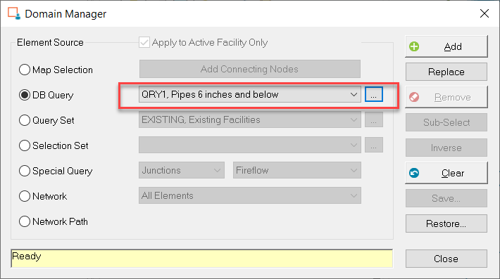

- Click on the
Edit Domain button from the InfoWater Pro Skeletonizer dialog box. Select
DB Query radio button in the Domain Manager dialog box, and click on the
Ellipsis
button to open the DB Query dialog box. Select DB Query “QRY1” as the current query on the DB Query dialog box.
- Choose the Add button on the Domain Manager dialog box. By investigating the map display you should see all 6 inches and smaller diameter pipes highlighted in red. These include pipes 16 (River Drive) and 100 (Lake Drive).

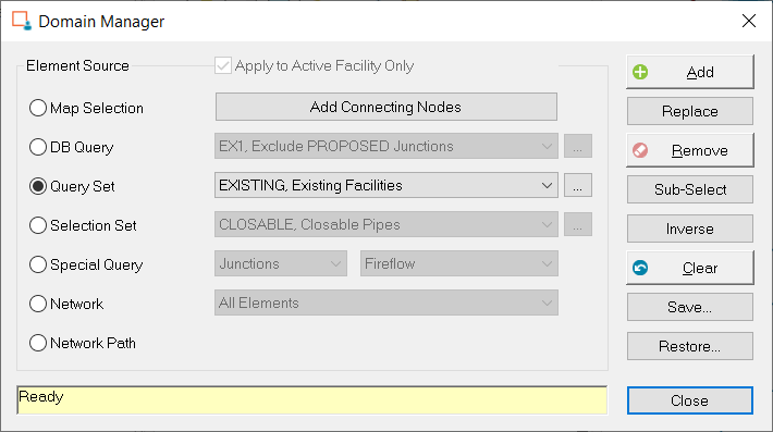

- Choose the
Edit Domain command from the
Skeletonizer dialog box menu. Select Query Set "Existing Facilities" as the current query on the Domain Manager dialog box.

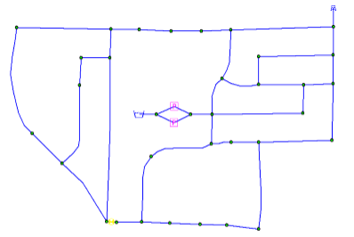

Choose the Remove button and then close the Domain Manager dialog box. Pipes 16 and 100 have been removed from the active network. The new network configuration is shown below. The final network comprises 31 pipes and 20 junction nodes with a total system demand of 707 gpm.
