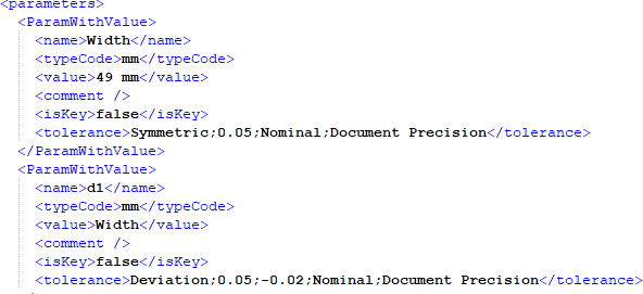

Tolerances in Export and Import XML files
The Parameter Tolerance settings for each model state are now included when you export and import XML files.
