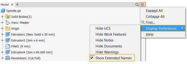

Display Extended Information in Browser Enabled for Multiple Commands
The options "Display extended information after feature node name in browser" (available from the Application Options > Parts tab, and "Show Extended names" (available from the Model browser tool's menu) are enhanced to support the following commands:
  • Face
  • Contour Flange
  • Flange

Access from Application Options > Parts tab:
Access from Model browser tool's menu:

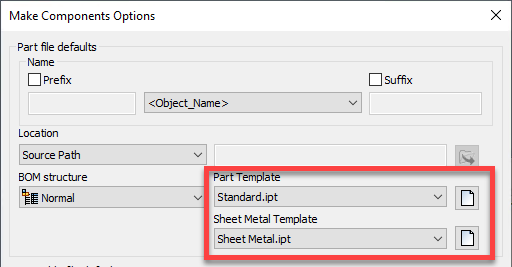

Sheet Metal templates
A new Sheet Metal Template option is added to Tools > Document Settings > Modeling tab > Make Components Options dialog to select or browse to the template used to create new sheet metal part files.
