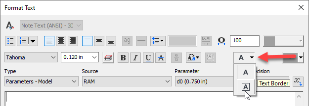

Show the Rectangular Border for Leader Text and General Note
You are now able to add the rectangular border for the 3DA Leader Text and General Note using the option in the Format Text dialog.

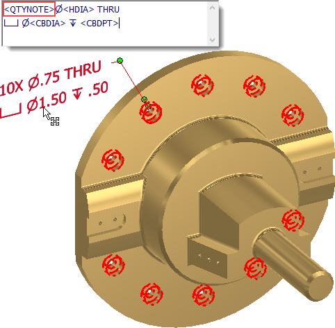

Hole Cross-highlighting
Cross-highlighting is enabled for holes participating in a 3DA hole note when using QTYNOTE.
