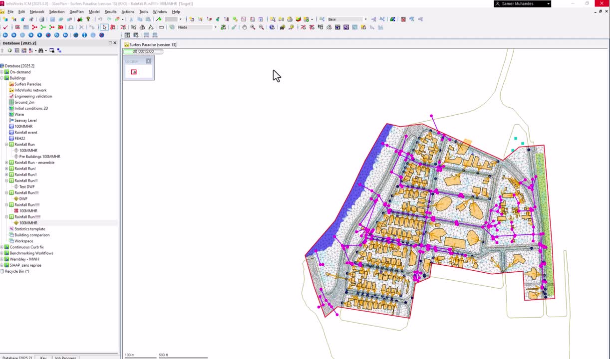

Export 2D to Raster (Tech Preview)
To provide an efficient way of exporting 2D results, which can be imported into GIS and other analysis systems, a new Export 2D to raster option is now available, as a Tech Preview, for 2D cloud simulations, whose summary results have been downloaded from the cloud.
It lets you export time varying or summary results as raster image files in TIFF format.
You can choose to export all the result attributes from a selected 2D simulation or only the attributes you are interested in.
If you choose to export time varying results, you can also export attribute results for a single timestep at a specific time or all results at a saved timestep. You can also limit the number of timestep results exported by changing the Timestep multiplier.
To access this new feature, a new Export 2D to raster option has been added to the Results menu, which displays the new Export 2D to Raster dialog. You can use this dialog to specify the export details mentioned previously as well as the type of units and resolution used for the exported images, and the location where the exported files are to be saved.
The following video demonstrates how this feature works:
