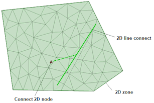

2D Line Connect *
A new type of line, 2D line connect, which represents a flow exchange boundary, is now available for InfoWorks networks. It lets you associate a Connect 2D node (a node whose Node type set to 2D and its Connection type set to 2D line) to multiple 2D elements in a 2D mesh that intersect the line. Previously, you would have only been able to use a Connect 2D node to connect a Conduit 2D to a single element.
The multiple 2D elements are used in the calculation of the flow exchange between the 2D surface and the associated node.
See the 2D Line Connect and 2D Line Connect Data Fields topics for details.
A theme has also been added to represent the new line on the GeoPlan. It comprises of a solid line between the start and the end coordinates of the 2D line connect object (default), and a dashed line, with the same colour, between the centre of the 2D line connect object and the Connect 2D node it is associated with. For example:
You can use the Layer Theme Editor to change the default theme for the 2D line connect object.
