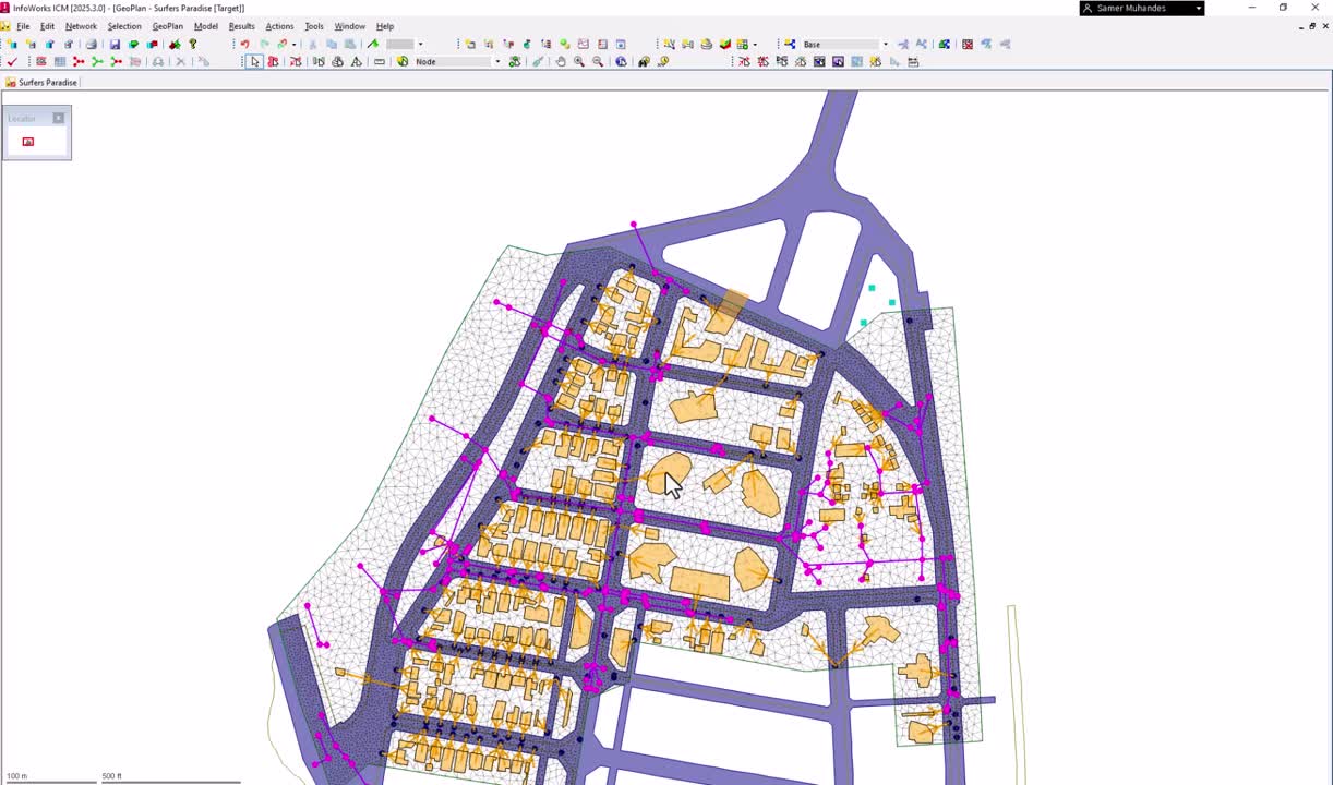

Buildings
The following improvements have been added to buildings:
  • Using Drainage contribution to model the impact of SUDS/LID*
    It is now possible to model the impact of a SUDS structure, such as a rain barrel, without using a SUDS control object. A new property, Drainage contribution, has been added to a building's properties. It is used to specify the percentage of runoff from the roof that enters the drainage system via a building's Drains to object, and is included in the total outflow calculation. The percentage which does not drain to the Drains to object is lost and therefore excluded from the total outflow. This loss can, for example, be attributed to the impact of a SUDS structure. See SUDS modelling in buildings for details.
  • Perimeter option for Exceedance flow type
  • A new option, Perimeter, is now available for Exceedance flow type. If selected, any storm runoff from a building's roof, which is in excess of the Capacity limit, is directed to the boundary of the building, and included in the 2D simulation. This lets you model exceedance in the 2D mesh without having to direct it to a node location.
The following video demonstrates the changes to a building's properties and their effect on a 2D mesh:
Video Player is loading.
Current Time 0:00
Duration 0:00
Loaded: 0%
Progress: 0%
1x
Name change for Additional DWF Baseline property for SWMM nodes
To be consistent with the naming of properties in the DWF section of a SWMM node, the name of the Baseline property for the Additional DWF properties has been renamed to Base flow. There has been no change to its behaviour.
