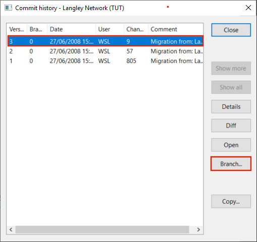

  1. Right-click the Langley Network (TUT) network in the Explorer window, and select Show commit history from the pop-up menu, and a Commit history window is displayed.
  2. Select the version at the top of the list and click Branch.

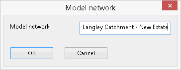

  3. A New Database Item dialog is displayed. In this window:
  4. Name the network 'Langley Catchment - New Estate'. Click OK.

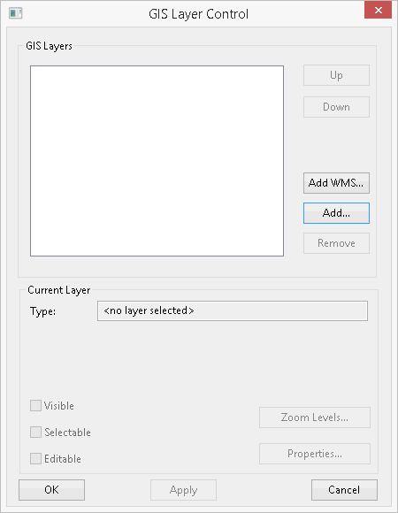

  7. Right-click the GeoPlan and select GIS Layer Control from the pop-up menu. The GIS Layer Control dialog is displayed:

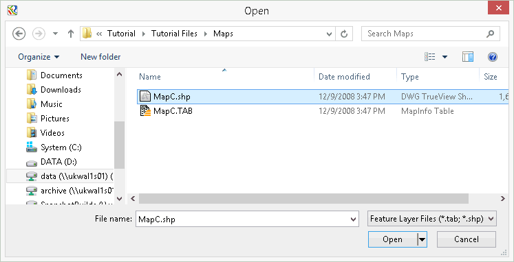

  8. Click Add, and then in the Open window, browse to 'Tutorial File/Maps' and then select the 'MapC.shp' file.
  9. Click Open and the Open window closes. The selected 'MapC.shp' file is now displayed in the GIS layer pane of the GIS Layer Control dialog.
  10. Select Apply and then OK to save the changes the map layer. The GIS Layer Control dialog closes and the background map is displayed in the GeoPlan.

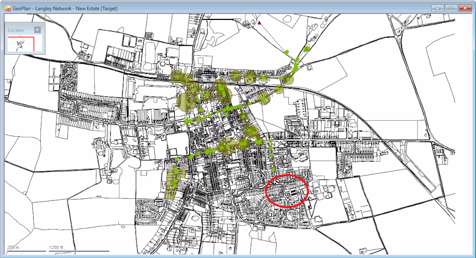

  11. Zoom to the new estate. This is highlighted on this GeoPlan example:
    Note that there are currently no nodes or links serving this area of the network.

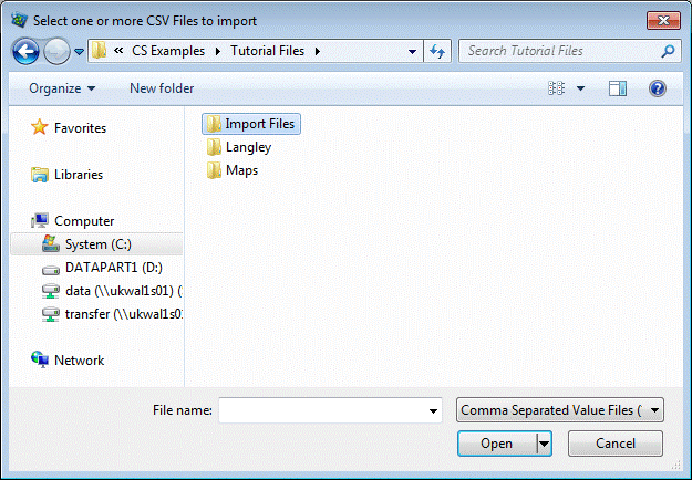

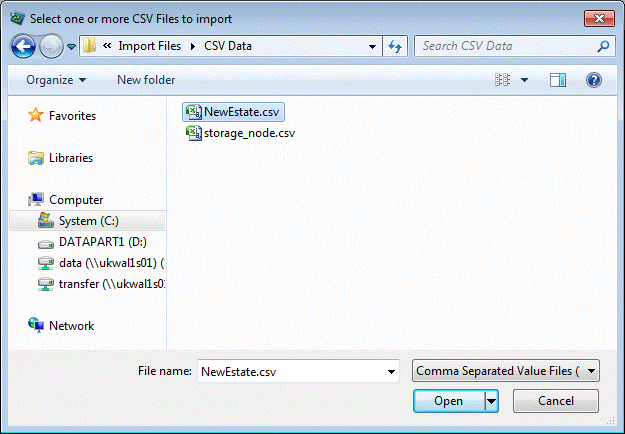

    2. Click OK to use the default values for the import operation. You are now requested to select the CSV files to import:
    3. From the Example Data Directory, select 'Tutorial Files/Import Files/CSV Data/NewEstate.csv' and click Open.
      The selected 'NewEstate.CSV' file is imported. It is possible to import another CSV file but this is not required.

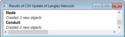

    4. Click Cancel to close the window. A window is displayed, detailing the number of objects (nodes and links) that have been created.
    5. Click to close the window.

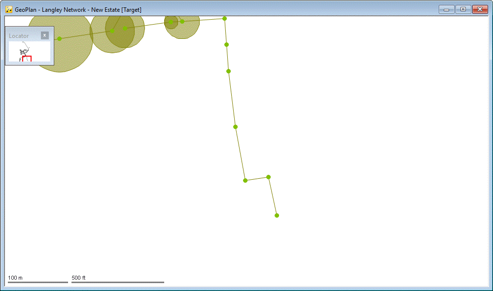

  13. Switch off the display of the background map(s). To make any background map or layer invisible, right-click anywhere on the GeoPlan and select GIS Layer control from the pop-up menu. In the GIS Layers Control dialog, remove the check from the Visible box (by clicking it) which will hide the layer. Click OK to accept the change and close the dialog.
  14. You can now see that the imported data forms a small network connected to the existing network:
