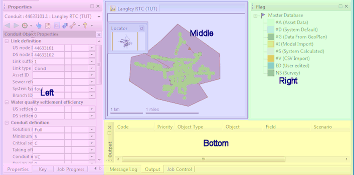

The Main Window can be divided into three main areas:
- Left - The left part of the Main Window is the default location for the following windows:
- Explorer Window - displays the data in the current database in a hierarchical tree view.
- Object Properties Window - displays the Property Sheet for a selected network object. Property Sheets provide a way of looking at all the data for a single network object in a structured and customisable way.
- Thematic Key Window - displays the GeoPlan Window symbols and current themes for the open GeoPlans in a tree view.
- Job Progress Window - displays the status of the job currently being executed.
- Middle - The middle part of the Main Window is the default location for the following windows:
- GeoPlan Window - displays a selected network. This window is opened by dragging the icon for a network from the Explorer Window onto the main window background.
- 3d Network View - provides a view of the ground surface of an InfoWorks network that has a ground model loaded on its GeoPlan View.
- 3D Manhole View - displays a 3D animation of a selected manhole and connecting links.
- Network Object Grid Windows - spreadsheet-style Grid Windows listing objects present in the network.
- Bottom - The bottom part of the Main Window is the default location for the following windows:
- Long Section Window - displays a cross-section through the length of a selected run of network objects.
- Output Window - lists any errors or warnings following a network validation.
- Job Control Window - displays the order and status of scheduled jobs.
- Right - The right part of the Main Window is the default location for the following windows:
- Flag Window - displays the available data flags for the current database.
- Spatial Bookmarks Window - displays the spatial bookmarks for the current network.
Show me an example of the Main Window workspace
Example of layout in InfoWorks ICM
