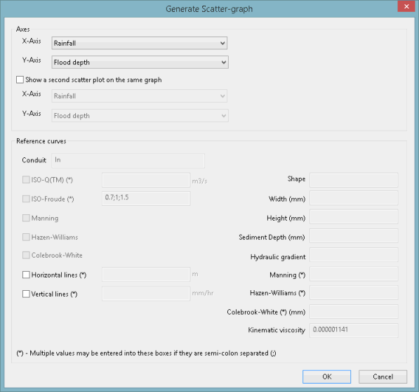

The dialog is displayed
if you click on the Scatter Graph button (
) on the Graph toolbar.
If there is a network open, the extended version of the dialog will be displayed.
Scatter Graph Dialog - Extended
If no network is open, you will not be able to display reference curves, and you will see the basic version of the dialog.
Scatter Graph Dialog - Basic

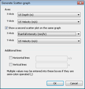

Scatter graph options
Axes
Select at least one pair of variables to display on the scatter graph. You have the option to display a second pair of variables on the same graph by checking the Show a Second Scatter Plot on the same graph box. The second plot will be shown using an alternate colour by default.
You can change the plot options in the Graph Properties dialog.
Additional lines
You can add additional gridlines to the view if required. Check the Horizontal Lines and/or Vertical Lines boxes. Then add one or more values for your additional gridlines. Multiple values should be separated by semi-colons.
Reference curves
The extended version of the Scatter Graph dialog has additional options if you are graphing data with a network open. These options are only available if your primary scatter plot is Velocity against Depth or vice-versa. This data is only available for links.
The ID of the link whose data you are graphing appears on the dialog.
An alternative link ID can be specified by entering it into the edit box. If there is a link specified then:
- The link's shape, width, height and gradient appear on the dialog
- You can generate the following curves:
- ISO-Q
- ISO-Froude
- Manning
- Hazen-Williams
- Colebrook-White
- All curve types require shape, width and height to be defined. All are affected by sediment depth. In addition:
- Manning requires hydraulic gradient and roughness
- Hazen-Williams requires hydraulic gradient and roughness
- Colebrook-White requires hydraulic gradient, roughness and kinematic viscosity
Generating scatter graphs
To display a scatter graph:
Click the Scatter Graph button (
This displays the Generate Scatter Graph dialog.
- Select a pair of variables to display on the two axes.
- Check Show a Second Plot and then choose another pair of variables. The second plot will be shown using an alternate colour by default.
- Check Horizontal Lines and/or Vertical Lines to add additional gridlines to the graph. Then add one or more values for your additional gridlines. Multiple values should be separated by semi-colons.
- If you have a network open and you are plotting Depth against Velocity you will be able to plot one or more reference curves. See below.
- Click OK when finished.

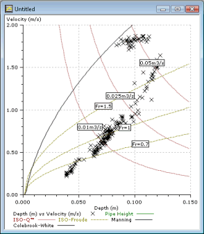

More information on reference curves
Manning Equation
Where n = Manning roughness coefficient S = Hydraulic gradient (m/m) V = Velocity (m/s) R = Hydraulic radius = D/4 (m) |
Colebrook White Equation
Where S = Hydraulic gradient (m/m) k = Hydraulic roughness (m) V = Velocity (m/s) D = Pipe internal diameter (m) g = Gravitational acceleration (m/s2) v = Kinematic viscosity of water (m2/s) |
Click on the image below to show an example of scatter plot with a number of reference curves applied.
Example
Scatter Graph with Multiple Reference Curves
