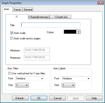

This dialog lets you to change the display properties of the graph.
Example
An example of Graph Properties dialog in InfoWorks ICM
It is displayed when you right-click on the Graph View and choose Graph properties from the popup menu, or when you double-click on the axis of interest on the graph.
Dialog description
- The Axes Page allows you to change the labels, ranges, and other display options for the x and y axes. Each separate axis has its own tab on the page.
- The Traces Page shows the style for each trace on the graph. Double-click on a trace on this page to display the Trace Style dialog.

The various options on the dialog are fairly self explanatory.
Note: Changes made to graph properties in this dialog will only apply to the current view of the graph.
Default properties
Clicking the Default button will prompt you to save the current settings on the dialog as defaults for future graphs. Only generic settings are saved. For example, axis titles that may vary from one graph to another are not saved.
